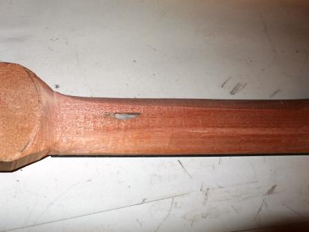

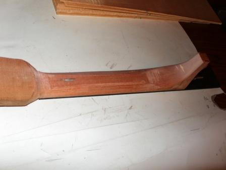

I was so happy to get to this point! Got the thickness to about .790" and thought "... let's get it to .770" and call it good." Well, as you can see, I struck Aluminum
Second neck,third fretboard and I thought I had it. Well, it gets easier each time.
Thanks for looking.
Laughing in Seattle,
Pete

Pete,
Thank goodness you can laugh at that! Been there, brother!
Paul Bordeaux
http://www.bordeauxinlay.com
PostPosted: Wed Apr 19, 2006 11:20 am
I guess it would be better to go absolutely through and know there was too deep a slot for the truss, etc
than get it within .001 or just enough not to know, and have it crack through when you or one of your customers adjusted the trussrod some time!
It must pain you though
Charliewood

PostPosted: Wed Apr 19, 2006 1:04 pm
Posts: 79
Hi Guys,
Well, I've seen so many exquisite guitars on the forum, especially firsts, that I thought I'd show some newbie mistakes.
Hi Paul, well I'm laughing now, but I leave on a two week business trip tomorrow and all I'll be dwelling on for the entire trip is the fact that I'll be "starting over" again!!
Charliwood - A Silver Lining!!! Yeah, if it had to happen I'm glad I found out now.
Joe - thanks for the empathy, I figure if you can't show something good, then show something!
In general, how much "meat" do you guys typically try to keep between the truss rod and the back side of the neck? Is there a rule of thumbe of sorts?
Thanks again for looking.
Pete
PostPosted: Wed Apr 19, 2006 1:32 pm
1/8" of an inch between the inside and outside world
0.77" is with the fret board yes?
That sure seems thin to me. I use a 7/32" thick fretboard and make the final thickness of the neck with freatboard 0.82-0.84 at the nut, that's nice and comfortable.
Now, I use a single action single rod which is burried 1/2" in the center of the neck and tapers up about 1/16" from the 7th fret to the nut so here are the numbers I work with.
Total FB & NECK=0.82"
FB=0.219"
Neck=0.60"
0.60"-0.44"-0.16" of "meat" remaining.
I guess you could go as low as 0.77" and still have 0.11" of meat remaining. All depends how deep the channel for the truss rod is.
Oh, by the way, I did the same thing on my first. I tryed to backstrap it, but it look awfull, so I built a new neck.Rod True38826.9400347222
PostPosted: Wed Apr 19, 2006 2:18 pm
Posts: 79
Hi Rod,
Thanks for posting your neck specs. I guess I was seduced by the thin neck!
I was using a Martin style truss rod from LMI and a pre-radiused and slotted fret board about .250" thick.
Man, I should have taken into consideration the depths and thicknesses.
Oh,well, another excuse not to have to watch American Idol!!!!
Thanks for posting Rod.
Pete
